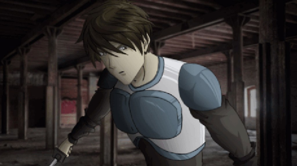

We will work on creating a dramatic scene of a warrior having a hard time against his enemy. This will be depicted with the character being tired, breathing heavily and showing different emotions on his face; letting us know that he is thinking and considering options to take down his adversary. All of this will be accomplished by first preparing the character in Photoshop, adding cell shading for a dramatic effect, and easily animating it in CrazyTalk Animator 3. Once you have the character ready for animation, you can move it in any way you want, and you can use it to create other animations as well.
