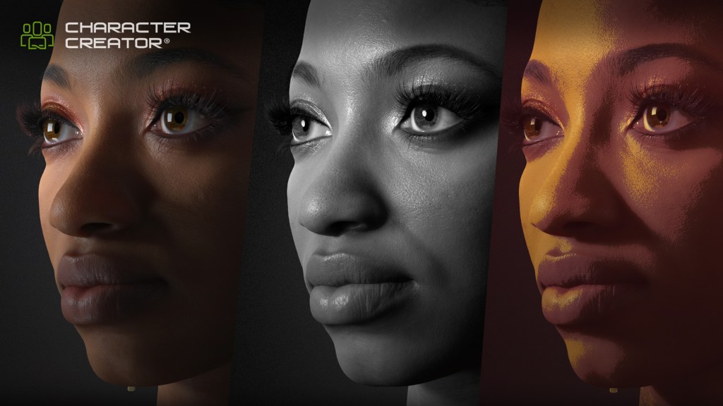

The Ultimate CC5 3D Lighting Guide: Create Cinematic Realism with Free Presets
Lighting is one of the most powerful tools for defining mood, realism, and style in Character Creator 5 (CC5). The free 3D lighting presets give you an excellent foundation to start with — but to truly make your character shine, you’ll want to move beyond simply applying a preset. Fine-tune the lighting to match your character, theme, and camera angle for the best visual results.
This guide walks you through how to make the most of CC5’s Lightrooms and how to adjust presets so they perfectly complement your scene.
