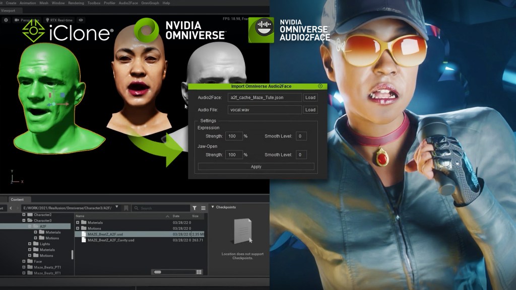

Once I had the base body mocap done, I then exported my Character from iClone as a USD file, to Audio2Face. I made sure to check the “Include Omniverse Audio2Face Mesh” check box in the Export USD dialogue box. That step is extremely crucial because it offers Audio2Face the ability to recognize your character’s face so you can use the AI to create the facial mocap from an audio file.  I also made sure to select the render mode. I chose to export both the RTX and the Path Tracing render mode as 2 separate versions of my character, so I could have the option to preview the animation in real-time as well as render the character using the Path tracer in Omniverse.
I imported my rap artist character into Audio2Face and began the process of using the built in AI to transfer the facial motion capture data derived from the rap vocal wave I mentioned in the earlier steps of this workflow.
Audio2Face Highlighted Steps
I was blown away at how well Audio2Face was able to use the vocal of my female rap artist to create the lip sync animation! Audio2Face also offers several powerful tools under the Emotion tab, that make it possible to add nuanced lip movements after the ai applies the data from the audio file onto the characters head.
After applying the Facial mocap to the head of my character in Audio2Face, I exported the data as a json file, with just the lower part of the face.
I imported the JSON file with the lower facial animation from Audio2Face, into iClone, and applied it to the Rap Artist character using the Omniverse plugin.

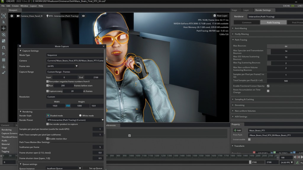

Once I was happy with both the facial animation and the full body animation, I selected my rap artist character and exported her as a USD file from iClone to Omniverse. I exported 2 versions, one for RTX and another for Path Tracing. Doing it that way offered me the flexibility of choosing whether to render using Path tracing or Real-time rendering in Omniverse.
Exporting as Path Tracing has the advantage of providing Omniverse with a character that has a beautiful skin shader that supports subsurface scattering (SSS). The Character Creator models come prepared with a beautiful skin shader that looks great when rendered with path tracing in omniverse, but they also take longer to render compared to the RTX version.
I loaded my rap artist into a scene I had prepared using a set I exported from Daz Studio as an FBX, and loaded into iClone. I used iClone to set up the audition stage, and also placed the character in the focus area, which I then used to set up different cameras that I knew I would need to render from once I got to Omniverse. It’s truly awesome that Omniverse supports all the lighting and camera animation from iClone.
I set up some additional lighting inside of Omniverse to bring the stage to life and to add camera movement. To preview the animation before rendering, I set the display in Omniverse to real-time, which made it very easy to iterate and make camera and lighting adjustments.
I rendered the final animation using Path Tracing. Having a good GPU goes a long way toward speeding up your renders in Omniverse. I also used the built-in denoiser to help speed up the renders.
