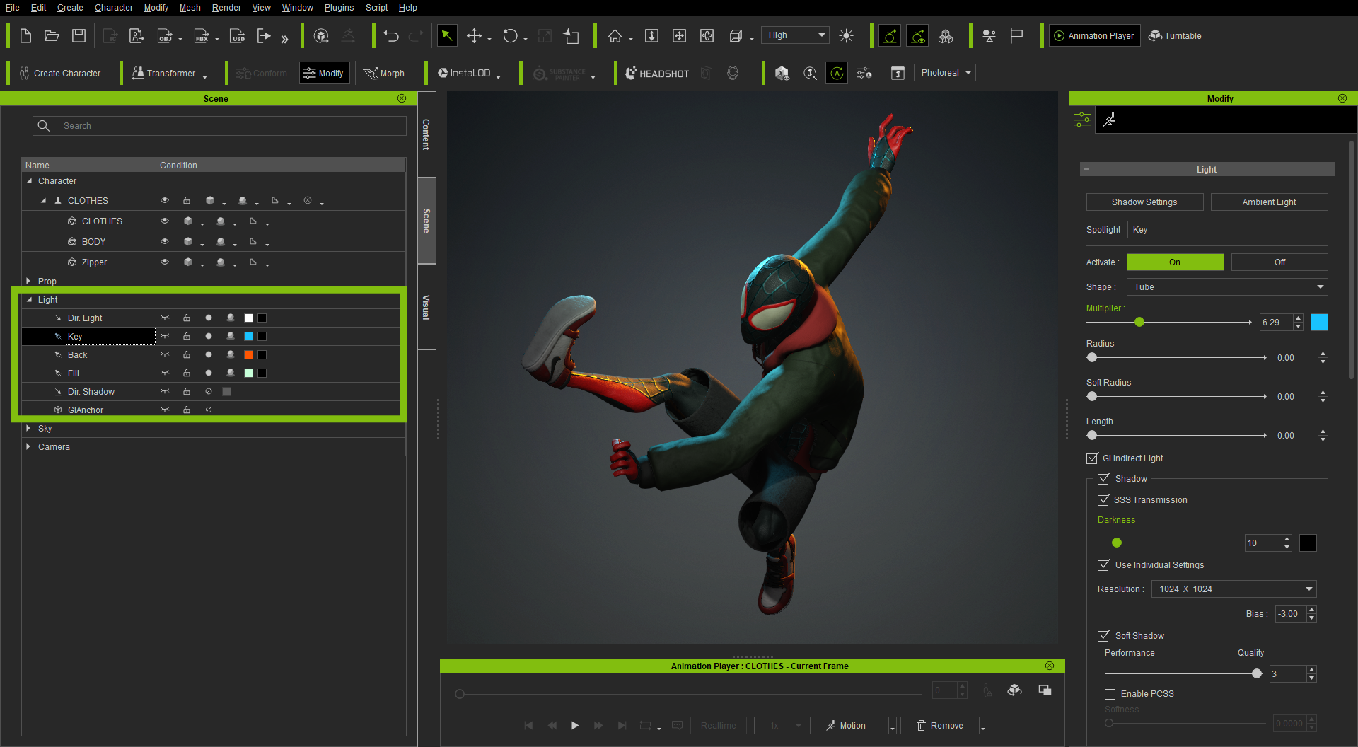

That covers the main steps. Now, you can proceed to rename this newly created pose and organize it alongside your other poses within the same ZTool in ZBrush.To conclude the process, select a pose that you prefer among the different alternatives you generated in CC4. Then, employ vibrant and colorful lighting in Marmoset Toolbag 4 to render the chosen pose.
The render is actually something else you can do directly from CC4 and is just a matter of playing with the lights a bit.
