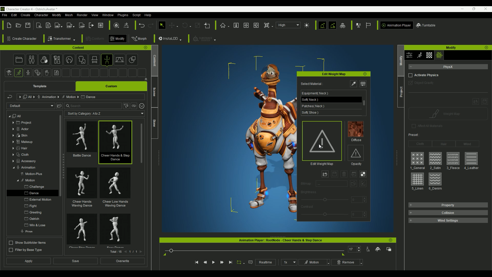

Animating Dynamic Accessories
At this point, I will add the Spring bones and Cloth elements in Character Creator. For this, I select my model and click the Modifier > Spring Bones button. With the window open, I mark the bones I want as Spring bones and set the weight, strength, and bounce attributes accordingly (the wings and the flag on the backpack for example).
Figure 6: Spring Bones window
For the neck, I use cloth simulation to enhance the animations with the use of a texture based on the UV of the cloth object (in black and white) that marks areas for simulation. This texture is added via the Edit Weight Map window.
Figure 7: Weight Map window
With this setup, I can concentrate on the main animation and let iClone handle the dynamic simulations.
