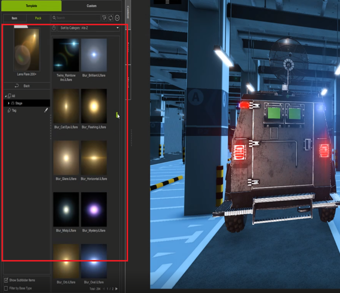

Under Content go to Stage. (Fig 3.0)
Fig 3.0
Under stage you can see lens flare 200 plus. (Fig 4.0)
Fig 4.0
You can buy this Lens Flare 200+ pack from the Reallusion content store. There are different type of lens flares there.
