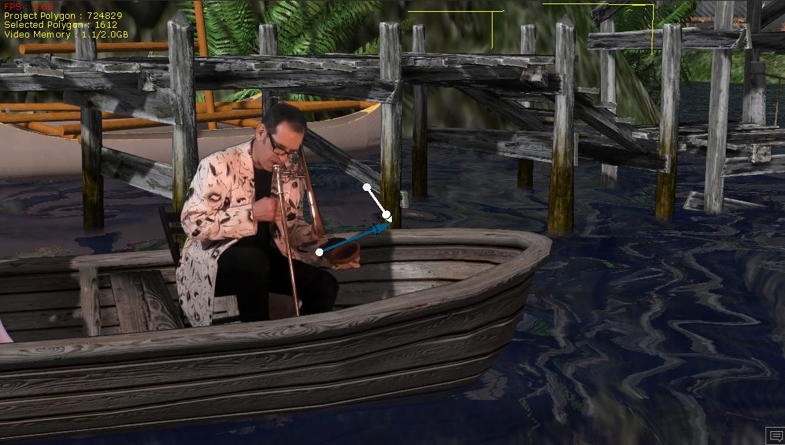

The trombone player was shot a few weeks later at a different studio.
There were two closeup captures that the client wanted to feature — but without the close-ups actually filling the screen. This meant finding ways to re-frame the closeups.

Actually, the biggest problem I faced was with the trombone player’s performance. It turns out that the trombone player had totally improvised his performance on the studio recording. So it was nearly impossible for him to replicate his performance for the video capture. In post-production I had to re-time some of his motions to try to match the studio recording. It was a nightmare. In this kind of video you can’t allow any of the animation to detract from the live performance. The digital avatars cannot upstage the singer. So it was necessary to find a way to keep the avatars under-animated and under-lit without them becoming statues or zombies.
