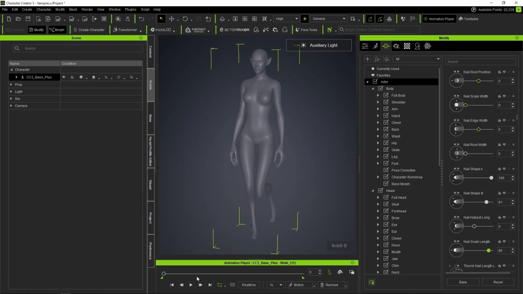

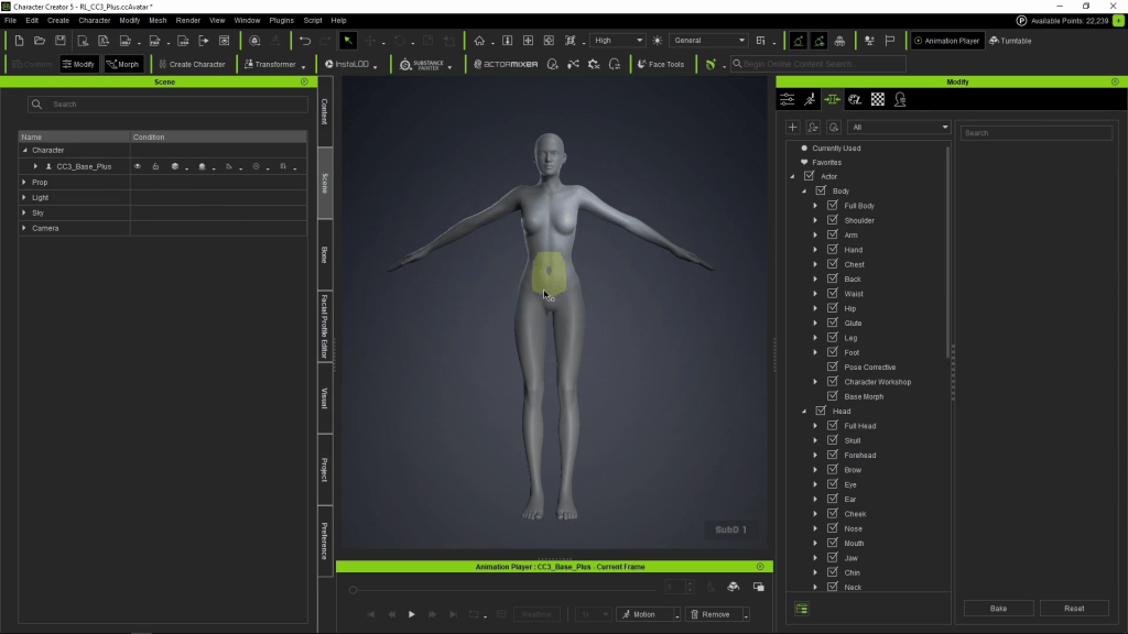

Base in CC5
Load the neutral HD base, set proportions with body modifiers and detail sliders, clear the pose, then GoZ to ZBrush with diffuse and normal maps switched off.

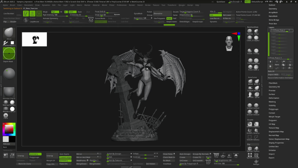

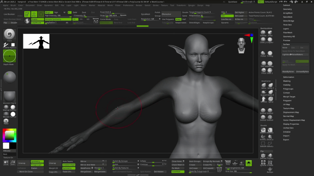

Sculpt the body via GoZ
Sculpt facial structure, anatomy, and the digitigrade leg break at subdivision level one, sending the mesh back at level zero whenever topology or proportion changes need to be verified against animation.

Sliders Instead of Sculpting
The most repeated lesson in the series is that CC5 should absorb anything parametric. Knuckle thickness, finger length, nail shape, ear type, thigh-to-calf ratio: all of it moves faster on a slider than under a brush, and all of it stays symmetrical and topologically clean. When Fernández wants the shins longer and the thighs shorter, he says he could do it in ZBrush, “but as you can see, it’s just a matter of moving two sliders.”

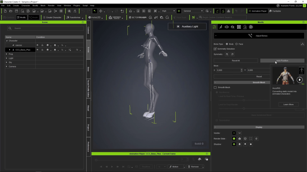

Bones That Follow the Morph
The digitigrade legs are the real test. Fernández splits the ankle joint upward in ZBrush so the hoof can behave as a foot, then sends the mesh back. The first walk cycle looks wrong, and the cause is skeletal, not geometric. Auto Position rebuilds the bone placement against the new silhouette, and the character walks correctly on the tips of the hooves. That single step is what keeps a non-human body plan animatable.
Test at Every Stage
He returns to CC5 constantly, at subdivision level zero, purely to check behavior. It costs seconds and catches problems that would be expensive to unwind later.

Sculpt Low, Detail Late
Fernández sculpts the face at subdivision level one, using the CC face-region texture map as a guide so that his edits respect the deformation zones the expression system depends on. He is emphatic about resolution discipline: work high too early and “that plastic effect will start to appear, which looks really, really bad.” Volume first, detail last.

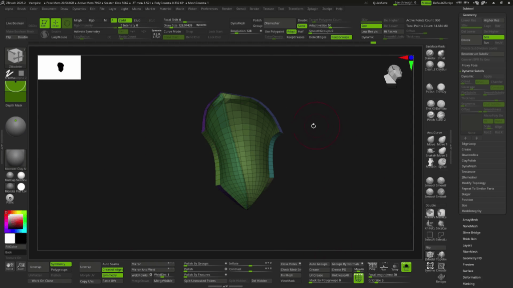

Polygroups as a Hard-Surface Engine
Nearly every accessory in the series follows the same recipe: cut the shape, define polygroups at every intended edge, then alternate Polish by Groups and ZRemesher until the surface is clean and the edges survive. Thickness comes from dynamic subdivision rather than manual extrusion. It is a low-poly, high-control approach that produces armor, helmet panels, and belt hardware without ever leaving sculpting mode.

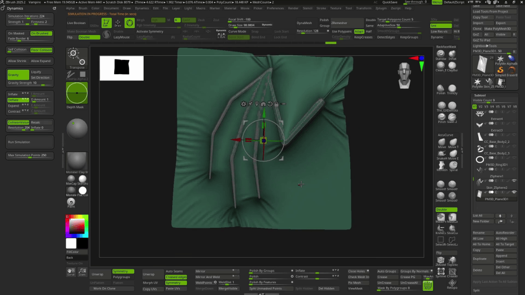

Physics for the Things Sculpting Does Badly
The wing membranes start as ZSpheres, then get a flat plane draped over the finger bones and simulated with ZBrush dynamics against a calculated collision volume. Fernández drops the firmness almost to zero so the cloth sags naturally. The resulting folds, he notes, would be “pretty hard to sculpt.” The same technique settles the skirt against the legs.

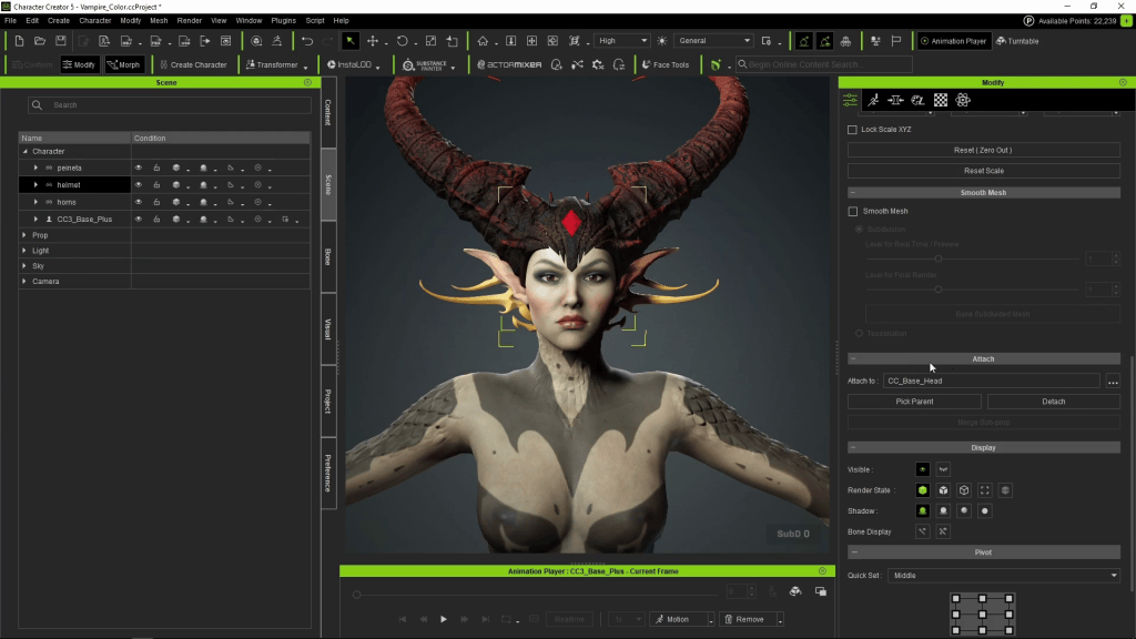

Accessory or Clothing, Not Both
Bringing the pieces back is where the series is most useful. Rigid parts, horns, helmet, shoulder pad, forearm guard, come in as accessories and get bound with Pick Parent to the correct bone. Deforming parts, hooves and the lower garment, come in as clothing with Transfer Skin Weights using the shoes preset, then Conform to calculate collision. Anything left intersecting gets fixed with Mesh Editing sculpt tools directly in CC5.
Displacement and normal maps transfer separately per subdivision level, so level one and level two each need their own bake.

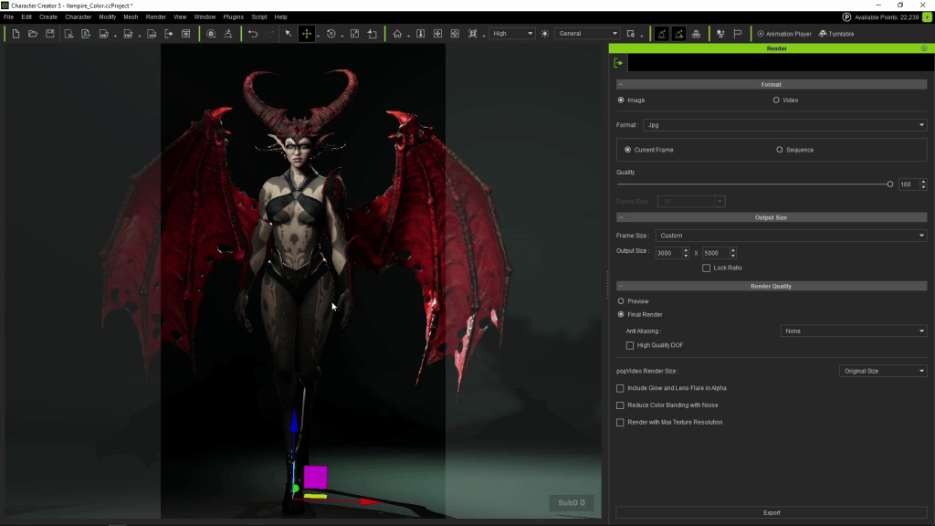

Rendering Without Leaving CC5
Fernández builds the final image entirely inside Character Creator: a preset stage, a tuned five-light setup, a rescaled and recolored backdrop, then a pose assembled from a preset, hand-adjusted joints, hand presets for the claw gesture, and a facial expression tuned through both muscle mode and sliders. He renders at 4000 x 4000 at subdivision level one, with depth of field. His verdict on the output: “we don’t need any other program.”

  • Run Auto Position after any major proportion change. Non-human silhouettes only stay animatable if the skeleton follows the morph.
