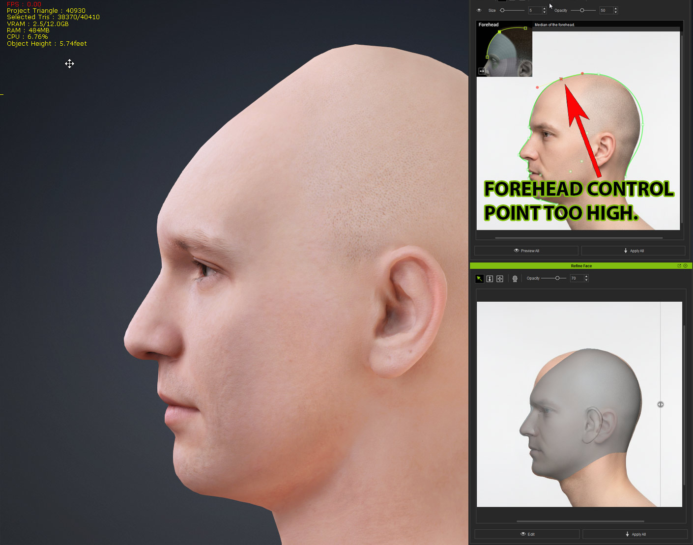

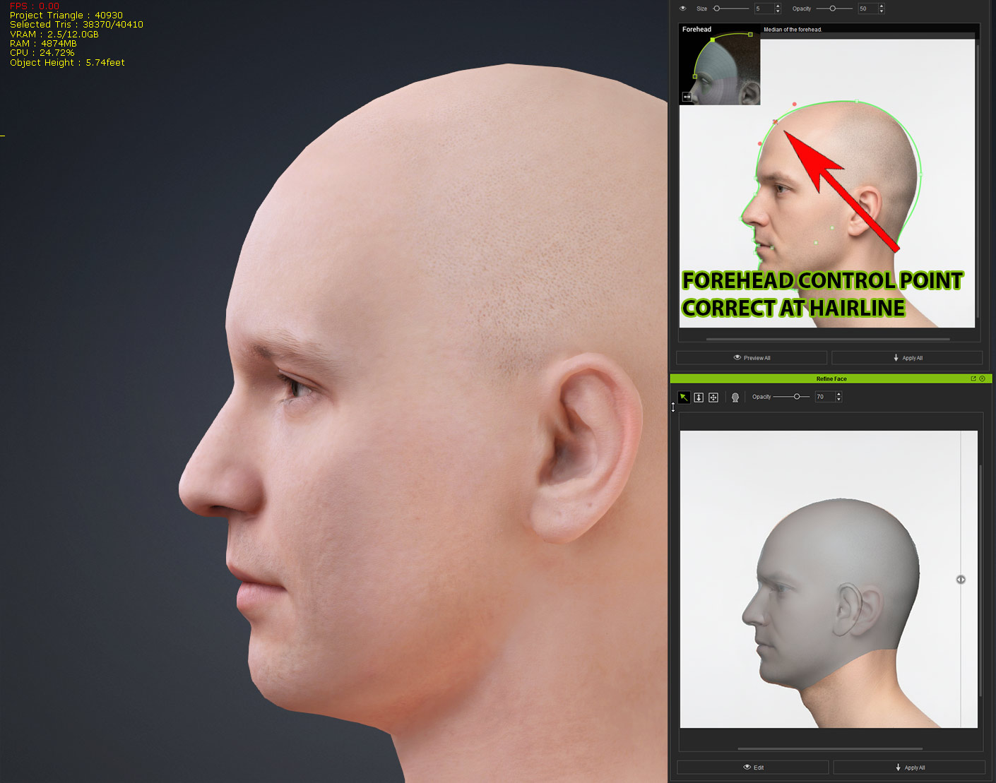

While using the Side image gives us more control points it can collapse the forehead if used improperly as the side view sets the forehead (and head) depth in general. If you place one particular control point too high on the head the forehead depth or volume will collapse and curve awkwardly inward, then back out.
To avoid this the top front control point needs to be placed at the hairline or where the hairline should be. This will ensure enough volume to keep the forehead from distorting when shaped from the side. After this we can then fine tune the forehead volume if needed.
The video below demonstrates this and how to correct it and the Reallusion Tutorial further down in this article goes into more detail.

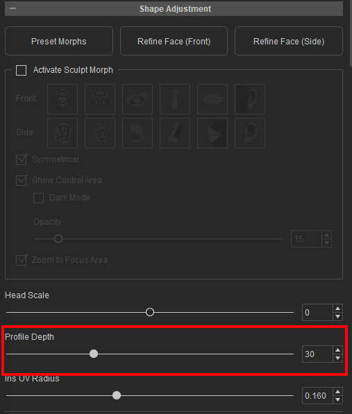

The Profile Depth Slider
To get a character all we need at minimum is a forward headshot. This sets the face features and other landmarks. Due to it being a forward view the face can be a bit flatter than normal so we can use the Profile Depth slider to project face outward more or draw it inward. If the nose seems a bit flat, then the slider will extend the nose along with all the other facial features adding more depth.
The same thing can happen with using both front and side as the front image still determines the height just like using a single front image with no side image.

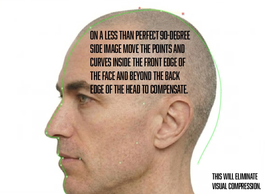

A Less-Than-Optimal Side View
If you are using a side view that is not exactly 90 degrees, then it can lead to distortion of the head mesh. The Reallusion tutorial below addresses this issue at the 4:50 mark. This explains how to use the refinement tool to solve this problem by forcing a better alignment with the placement of the control points.
If we try to use a less than 90-degree side view the depth of the head will appear narrower and if we do not adjust for it as shown in the video, then skull compression can happen reducing the distance between the front and back of the head creating a less than desirable skull shape.
The video tutorial below from Reallusion explains all of this and demonstrates how to compensate for a less-than-optimal side view image ensuring your characters look like YOUR characters not just a close semblance of them.

The main thing to remember if you get a distorted forehead mesh is to go back and place the affected control point closer to the proper position like the area of the hairline in this example. Since the side view only works with depth and not height you must use the front view refinement window to change things like the top of the head height demonstrated in this article and tutorials.
